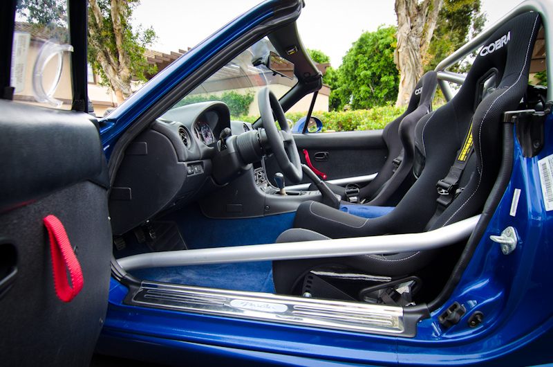

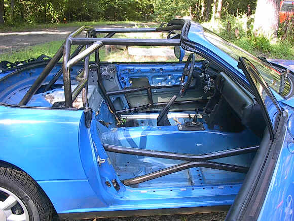

No modifications to the chassis are permitted, save for the usual weight saving measures of removing unneeded interior trim and the soft top. A factory hard top can be fitted, and the use of a fixed-back racing seat and five-point harness is mandatory.
