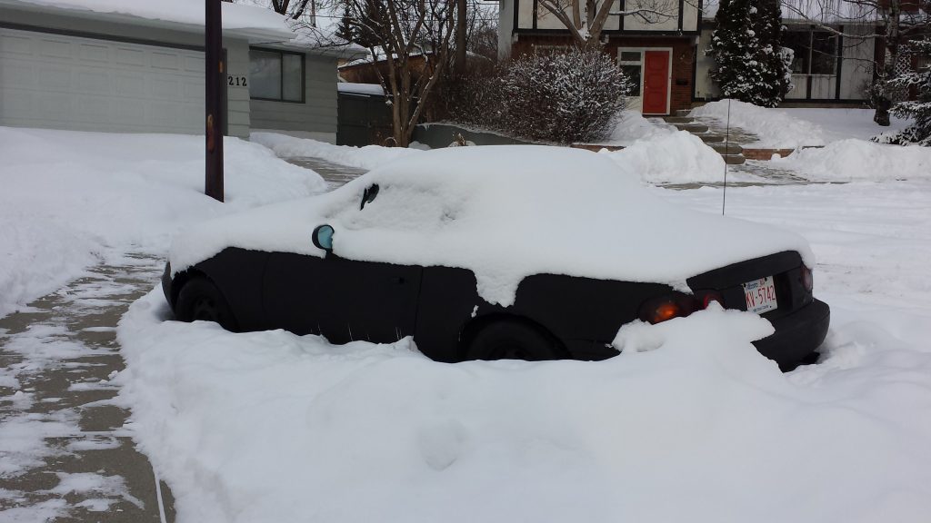

  • MX-5’s are light and can be more likely to become stuck, so make a plan in case you unexpectedly strike heavy snow. Carry a telescopic shovel, some kitty litter or salt in a bag to melt the snow, and a tow rope. It shouldn’t be too hard to find somebody to tow you out if you become stuck, but they likely won’t have a tow rope themselves.

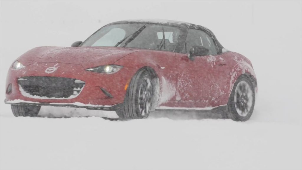

The cold, sunny days will be rewarding, and when the weather turns they will be met by the joys of piloting an MX-5 in low-grip situations. You just need to approach it with care and respect.

  • Regularly clear any built-up snow from the soft-top roof of an MX-5. The metal frame wasn’t designed to hold that weight.

  • When driving on slippery surfaces (and in general, too), absolute smoothness of all inputs is key. Drive as if there is a glass of water perched in between your legs, and you wish to avoid spilling it.
  • Never become distracted; you could find an unexpected patch of ice around the next corner.
  • If possible, try to find a wide, open and private space where you can find the slow-speed limits of your MX-5 in the ice and snow. Practise braking to a stop, turning into a slow slide and powering out of slow turns. We’re not encouraging you to go hooning about and you’ll need to find a private location to do this, but you’ll will be much better placed to avoid an accident on the road if you understand how your MX-5 will behave in an emergency situation and what its limits are. They may be surprisingly low.
