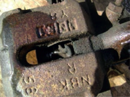

1

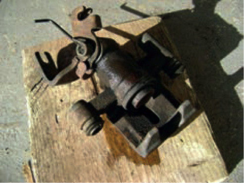

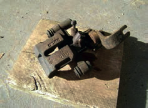

Once I’d removed the caliper from the car, it became apparent from the bleed screw arrangement, the finish of the casting where the brake pipe union mates and the type of piston fitted, that this caliper had been refurbished previously

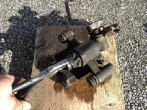

I was guessing that the piston would be rusted, causing it to be tight in the caliper body and as a result I would find that the threaded insert inside the piston that the adjusting bolt screws into would be separated from the piston. I wound the adjuster clockwise to extend the piston from the caliper body.

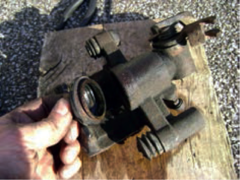

My suspicions became more aroused as the piston extended. Visible through the brake pad inspection hole I could see that the piston dust seal had become dislodged from its recess in the caliper body, allowing water ingress and now, visible rust.

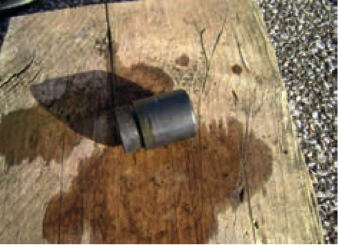

Once the piston was fully wound off the adjuster bolt I removed it by gently pulling it from the caliper body with a pair of pliers.
5
To my surprise, the piston was in fact in very good condition with no rust build up on it at all.

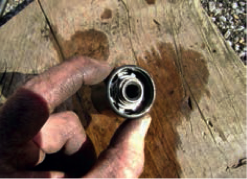

The threaded insert was also in place and secure, inside the piston.
