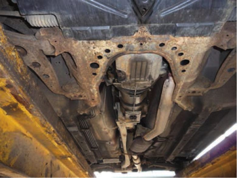

There was nothing serious of course. The car had recently had new springs, new rear calipers and discs and a new rear exhaust, but there was the expected surface rust. All the sills and chassis rails were sound, plus all the subframes and suspension wishbones. Nevertheless the MoT tester had put on the advisory “surface corrosion but not considered serious” for several underbody components. I had already committed myself to tidying this up before the next MoT and to do justice to the shiny bodywork on top.

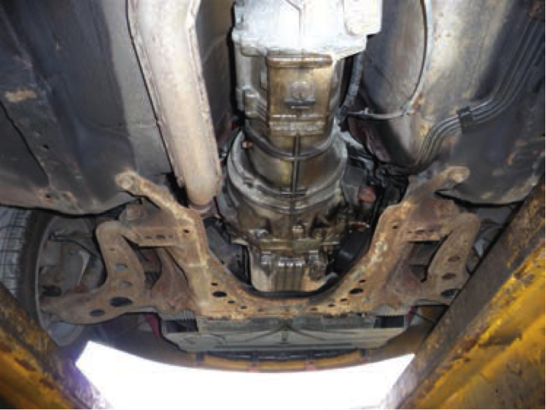

An appointment was duly made and I met with Nick at the Knutsford depot. Initial impressions were favourable and I was invited to stay and observe the process (which would take about 5 hours). Firstly the car went up on an external lift for inspection. Obviously if there were serious areas needing welding or other repair this would have to be done before treatment. Mine looked generally OK but with the usual accumulation of surface rust and road grime. This was followed by a power wire brush treatment (industrial version using a compressor) to remove any significant surface or loose rust, and finally a full underbody clean with a superheated high pressure water washer to get loose rust and dirt from nooks and crannies.
The next stage (after an initial drip dry) is a full compressed air drying of the underside, including all box sections. Bone dry is not necessary as all the Waxoyl products used are water displacing and injected under pressure so you can be sure that everything is covered. Preparation (which really is the most important phase) was now complete and the car was transferred to the workshop for treatment. A 4-point lift on the chassis rails is used to ensure that all underbody and wheel arch areas can be easily reached. All box sections (chassis rails, crossmembers, subframes, sills, wishbones, etc.) are treated with a clear wax spray which is injected at high pressure as a “mist” coating.
This penetrates any existing rust and prevents further rusting – important when corrosion so often appears from “inside out”. No holes are drilled as access can be made through existing points, such as drain holes and courtesy light switches.

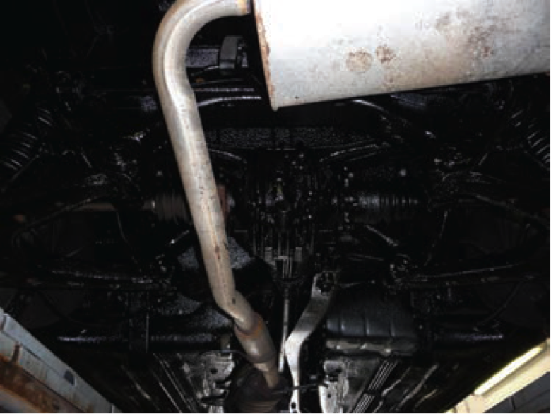

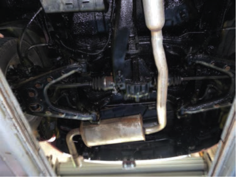

With internal cavities done the wheel and brake areas were masked off in preparation for the main coating. Again using a high pressure spray the entire underside area (apart from the exhaust) was covered with a thick black hard wax coating, which resembles a traditional underseal. However, this Waxoyl product penetrates and kills existing rust, remains flexible and can be “topped up” with additional treatment if worn or damaged. As you can imagine this process takes some time to complete and Ben (who did my car) was very thorough and careful to make sure every bit was covered correctly.
With all the work completed the warranty was issued (and windscreen sticker applied), masking removed and the car handed back over. There was some residual waxy smell, but with the hood down on the way home it was not noticeable.
Was it all worth it? Only time will tell but I’m looking forward at the next MoT to having no advisories about “surface rust but not considered serious”. At the very least I know the underside is sound, I know all surface rust is removed, what remains has been “killed” and future corrosion slowed down, at least for the next 5 years. And the cost? Well I know that Nick offered a 10% discount to CSMA members and the whole treatment was £325.
